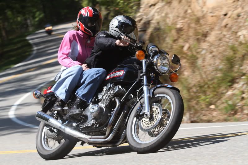

Sooo...I went back to the drawing board. She got stripped to the frame, bad parts in one pile (sadly the larger pile), good in another. Sanded, primed and repainted the frame. Anything getting reused was either painted or polished. New parts came from all over the world. The list includes: GS1100 swingarm as it is aluminum vs. steel, wire wheels off an early 1978 GS1000 (tapped to accept rotors on both sides as the wire wheeled GS thou's were single disc), forks to replace my bent one, Progressive fork springs and thicker fork oil, brake adapter kit from Saltymonk on a GS forum to mount the 1995 Honda CBR rotors and 1990 Kawi Ninja twin piston calipers (stock was just pie plate discs and single piston calipers), braided SS brake lines all around, new bearings all around, Superbike handle bar, cut down seat that my dad happened to have laying around, Ohlin's style piggy back shocks, Dyna S electronic ignition to replace the points, relay installed to ensure a full 12v constantly to the coils, new fender, tank repaired by a magician, new paint job, new headlight and housing, other odds and ends and lots more stainless hardware.
I'll post pics of the rebuild in the next couple days. For now here's a shot of her in motion on the Gap with the fiance pylon.
