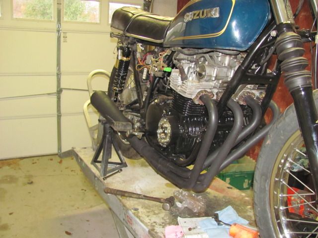

Next was the exhaust.  Dale said he thought that the collector/muffler that came with the Jardine system were for a different bike.  After I test fit the system I don't think that this is the case.  It seems to be correct, except that the hanger bracket is welded in the wrong location:
I will just cut it off and weld it in the right place.

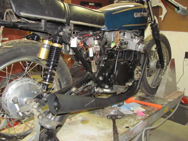

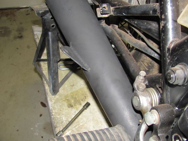

So, today I worked a bit more on the exhaust:
I cut off the mis-located bracket:
Did some grinding:
A little Hi-temp paint, and it almost disappears:
A little more work, and it'll be barely visible.
I set it up in the correct position to be welded...
...I just have to learn myself to weld with the new welder I bought.  Practice welds start tomorrow...
