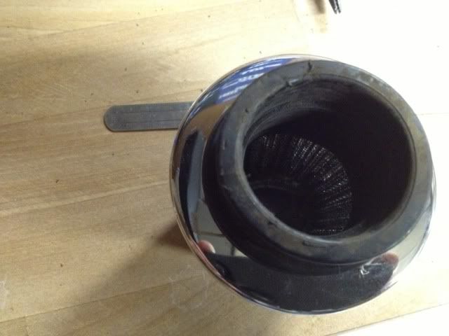

If you remove the rubber boot from the pretty, shiny chrome part and put it on the bike, you notice a couple of things:
1. The actual opening is much smaller than the carb throat. This causes resistance in the air flow (particularly at high RPMs) and the step in size causes turbulence, disrupting the laminar flow.
And 2. The boot blocks the air passages to the pilot jet and air pilot screw circuits.

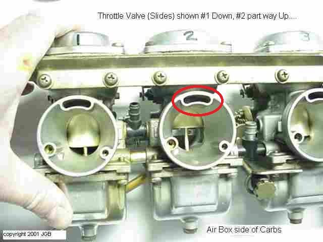

On CV type carbs, the boot would block the vent for the slide diaphragm, which would cause issues withe the movement of the carb slide:

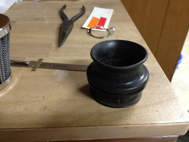

The original air box boots are shaped like a velocity stack to give the air a smooth flow into the carb throat. This is one of the center boots for my GS. The outside boots, actually look like elbows to turn the air 90 degrees into the throat:

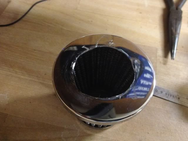

I ordered a set of K&N filters, but while I was waiting, I figured I'd play around with the Emgos. I cut the hole out and installed the original boot in the pod:
This would give you the smooth laminar flow, but would not address the poor filtering that the metal mesh provides. It would, also, require getting two more boots from another airbox, because the elbow shape of the 1 and 4 boots would not work well.

The picture of the CV carb is just one that I got off the Internet and circled tge vent hole.  That one is not mine.  I just used it as an example to show the vent.
