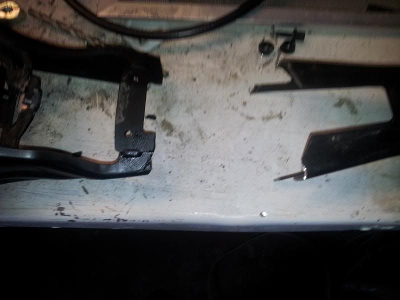

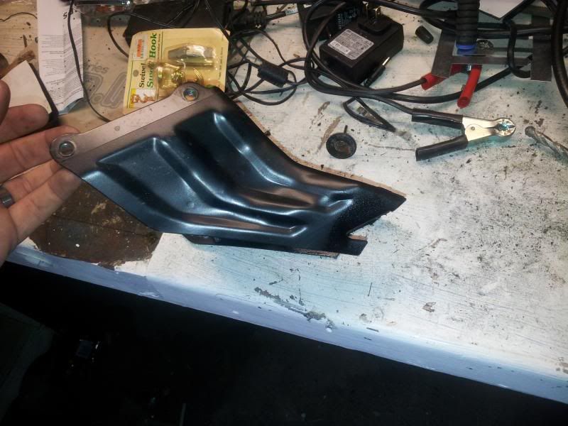

first step....cut!

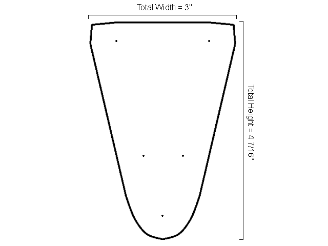

Then you make yourself a brack for the license plate holder to mount on to...this is the blueprint for it.
I did modify mine a bit and painted with rattle can Truck Bed liner paint...also did this to all the areas that were cut to prevent rust in the future after smoothing the corners.

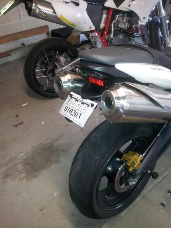

the use all stock hardware from the old tale that holds the license plate on.....
BEFORE:

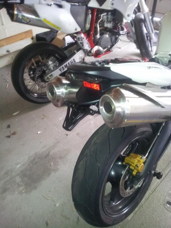

AFTER (there is no turn signals needed, I installed a smoke tinted integrated rear tail light and I am extremely happy with it:

« Reply #1 on: April 27, 2013, 09:08:08 am »
 :21 Looks great.Nice job.
Re: Re: Street Triple R DIY Tail Tidy
« Reply #2 on: April 27, 2013, 09:36:18 am »
Very nice
