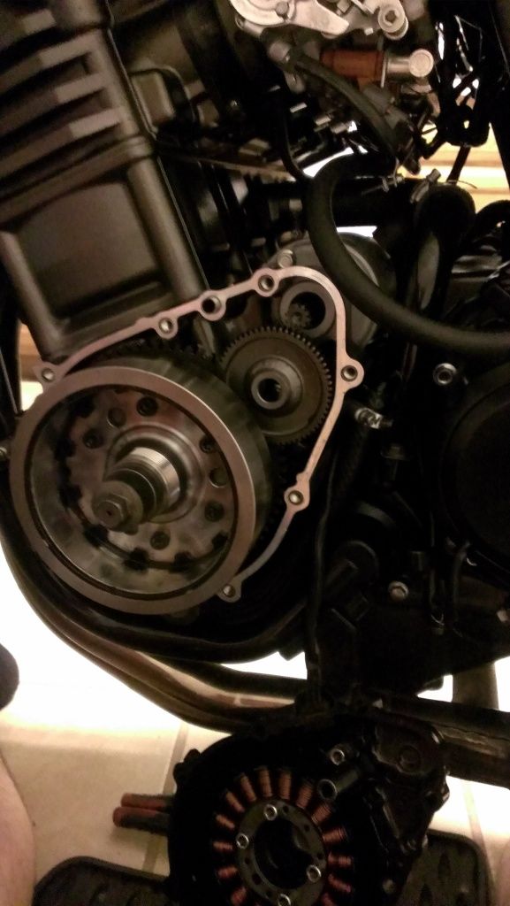

Real simple take the 8mm bolts out of the cover, then carefully pry the cover off. Might take a little effort depending on how you do it as the magnet is pretty strong holding the stator on. Be careful not to damage the gasket. (Its metal and reusable) should see this.

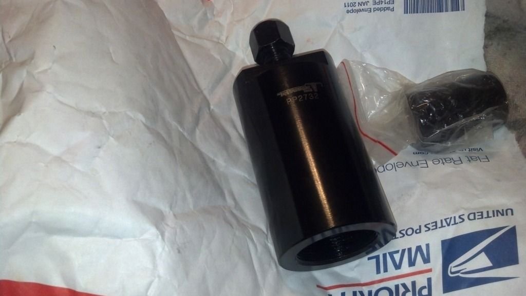

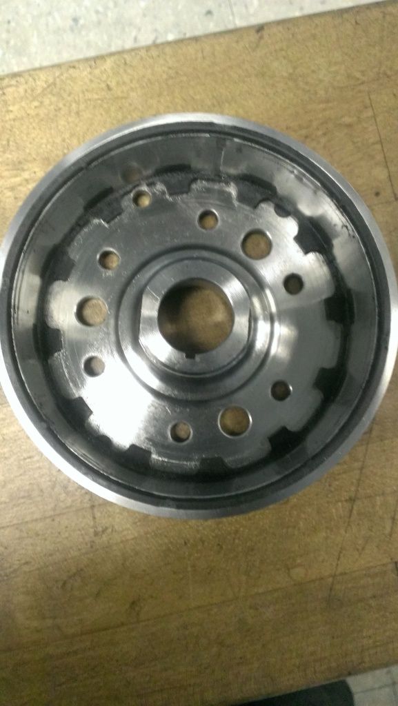

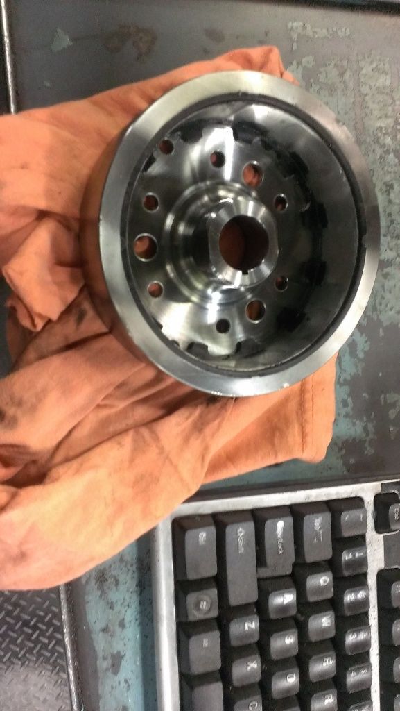

Take the gear out from the top right. The pin was in my case slot. If its still through the gear you will have to pull it out then the gear. Should be able to just pull with fingers or take a pair of pliers if needed and wrap it with a rag to not damage or mark the pin. Now take the center bolt out. Your going to need a wrench big enough to fit the outer diameter of the flywheel right behind the bolt to keep It from moving. Believe its a 17mm for the center bolt. I used my big adjustable for the other. Now its time to pull the flywheel. I had to modify a gear puller to work since I'm BROKE, lol but you can order them on eBay for like 28 bucks. Here's what it looks like. (Took the pic off z1000 forum) needs to thread on the outside of the center part of the flywheel then uses a bolt through the middle to pop the flywheel off. Going to take some muscle as this bad boy is on there. I also took the backing plate off prior to pulling mine but its not necessary. What you should have I shaved mine 11mm down from the overall diameter. This is what it looks like now. Did a lot of research on this before I committed to it. the guy that did it on z1000 forum did 10mm off of his and has put over ten k on it since with no issues. Couple more with same results. haven't found a bad report from doing it this way yet so I decided to go ahead. Will be reinstalling it when I get home to see how the bike reacts with this and the throttle bodies I did earlier in the week. Oh also if you have ever noticed wheel hop when down shifting or backing in to a corner this will almost eliminate it completely as it makes the motor come down quicker while giving you the quicker acceleration. Will update when I'm done.
