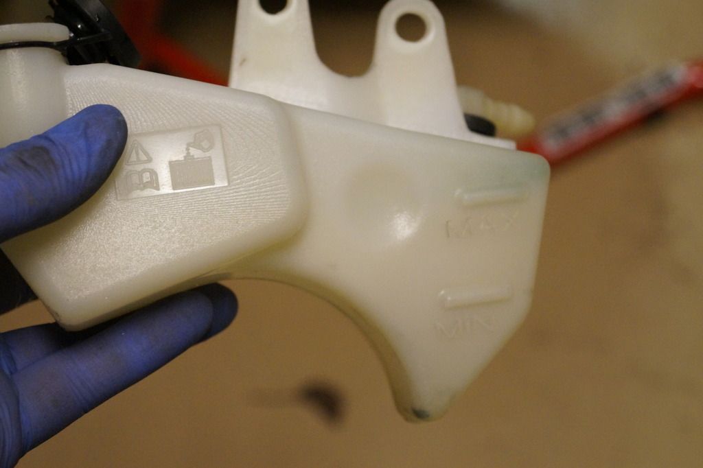

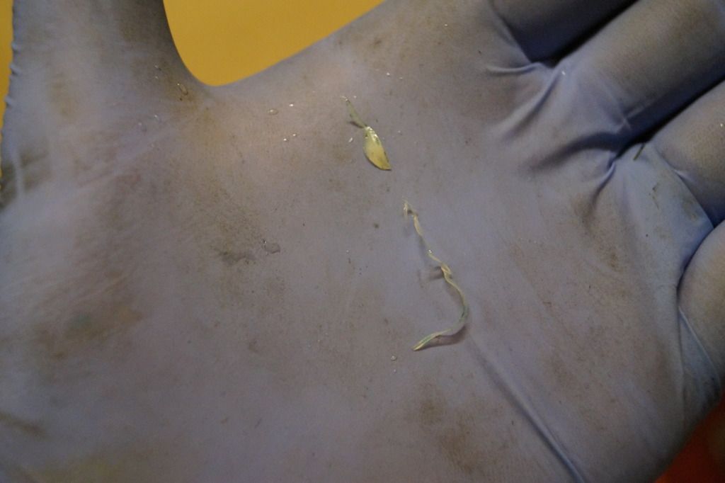

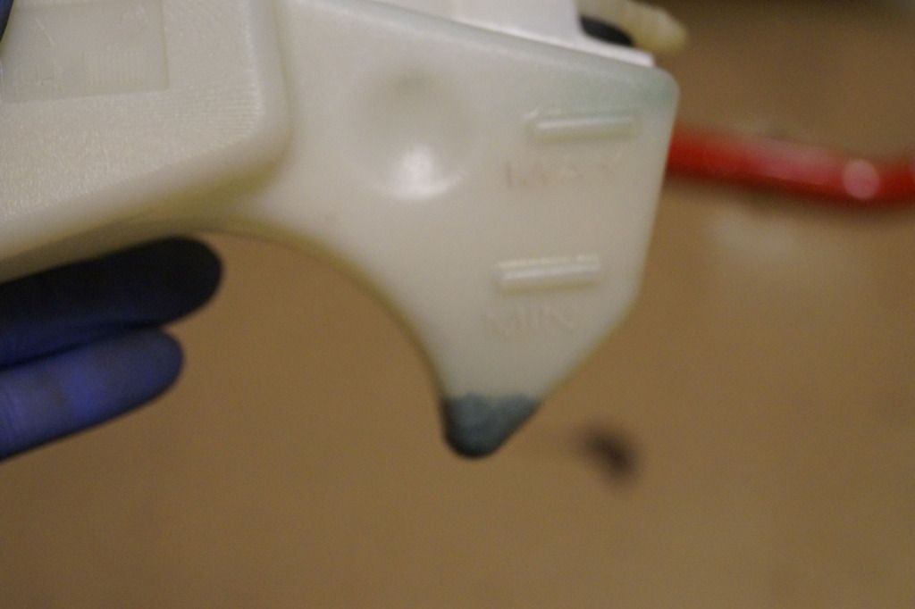

So while I wait for my order from BikeBandit I started on the flushing the coolant system. Here I found what appears to be bits of plastic in the coolant and stuck to the radiator cap. There was also an accumulation of ...something in the bottom of the reservoir. Removed the reservoir and cleaned it out.
Before I can fill the system back up I need the coolant drain plg gasket in the kit as well so that's where I stopped for the night. If the parts don't coming in tomorrow I'll probably start on flushing and bleeding the brakes.
