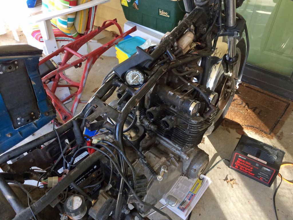

So, basically a good visual inspection and compression check was the order of the day.  First thing I noticed was a lot (a LOT!) of silicon sealant applied externally to every joint on the engine.  Plainly this motor has been leaking and the fella who had it wasn't too keen on opening anything up and replacing a gasket.  Also noted was a pretty cheesey attempt to paint the engine black.  Perhaps the guy thought a black motor wouldn't show leaks so much?  The engine ignition cover is broken and the other covers (generator, clutch, and sprocket) look kinda beat.  I have NOS replacement covers in my spares bins (except for my ignition cover...I just remembered Ian snagged it.) so that's no problem at all.  The good news is no broken bits like fins or mounting bosses.  Also, the engine was over-serviced with oil so that could be a lot of the oil leaks right there.  So, the visual inspection tells me we need new gaskets for the all covers including the valve cover and perhaps for the cylinder head and base gaskets.
Moving on to the the compression check I had some problems getting the motor to spin very well.  the wiring harness has been chopped up by that previous fella and I had to set up a good jury rig to engage the starter and cleaned the connections in the path to the starter.  After a bit of jumpering I hooked up the remote starter to the starter solenoid and using a fully charged battery and a charger in the 50 amp jump start mode spun the motor.  No compression at all, in any cylinder, just a hollow sounding "duwoop-duwoop" noise as the motor turned.  Hunh...   Jammed my thumb over the #4 spark plug hole and tried again.  Pop!  Blew my thumb off the hole.  Well...now what?  Short answer was a defective Schrader valve in the compression tester hose.  Fixed that.  Aha, now we have compression or, more correctly, now we can read the compression.
First run with a dry and cold engine
#1 = 100
#2 = 95
#3 = 75
#4 = 105
Second attempt gave me the same results except for #3 which went up very slightly to 80 psi.  Still not good.  OK, time to try it with a spoonful of oil down the spark plug holes.
First run wet and cold engine
#1 = 125
#2 = 120
#3 = 115
#4 = 125
Second run wet and cold (with a different gauge)
#1 = 125
#2 = 125
#3 = 120
#4 = 130
The compression test seems to be telling me that #3 probably is leaking at the piston rings.  Possibly its a head gasket or valves but since the compression went up so dramatically after adding a little oil to the cylinder that suggests rings.
One nice side effect of the compression test is I got to listen to the motor spinning a lot without exhaust noises.  No funny noises, the starter turned it over pretty fast, and the motor shifts through the gears OK.
Note the sealant around the ignition cover and at the cylinder base
So, right now my plan is to take the motor to be cleaned up by pressure washing to get the oily grunge off and then vapor blasting which will get rid of the ugly black paint and clean up the castings nicely.  Once it's clean then I'll pop the head and cylinders off, replace rings and then reassemble with new gaskets and o rings, checking the valves as we go.  Once reassembled then it'll be time to swap this motor out with Suzy's.  Then the real work starts.
